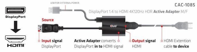

Example 1
The CAC-1085: This Adapter converts a DisplayPort™ signal into a HDMI™ signal. Inside the unit there is a hardware chip that converts actively the DisplayPort™ signal in a HDMI™ signal. The hardware inside can only convert One Way - UNI-Directional. Some adapters need external power. Others receive it through the cable port connection.

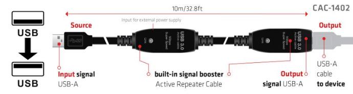

Example 4
The CAC-1402: USB 3.2 GEN1 Active Repeater Cable 10m/ 32.8 ft M/F 28AWG This cable features a built-in booster circuit that is external-powered through an USB power source, allowing you to connect your USB-A devices at distances of up to 10 meters with no signal loss. Inside the "Active Repeater" units, there is a hardware/processor that boost the analog signal. Without loss of Data Transfer Speed. The CAC-1402 supports data transfer rates up to 5Gbps over the full length of the cable.

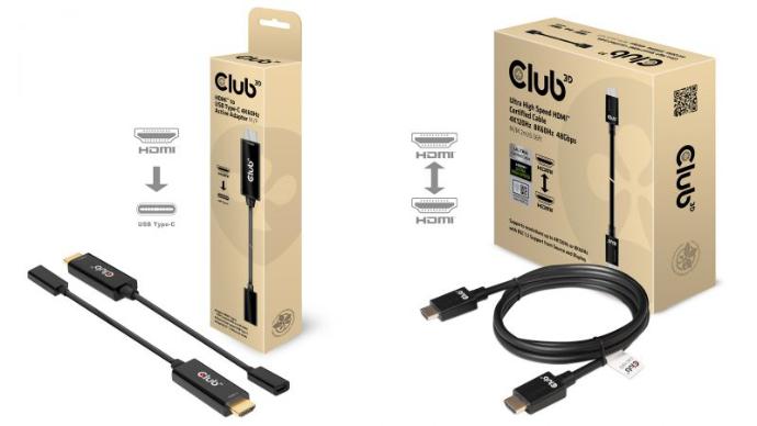

Box Examples
Left: HDMI signal converted to a USB-C port  Right:HDMI to HDMI - straight signal no conversion.
