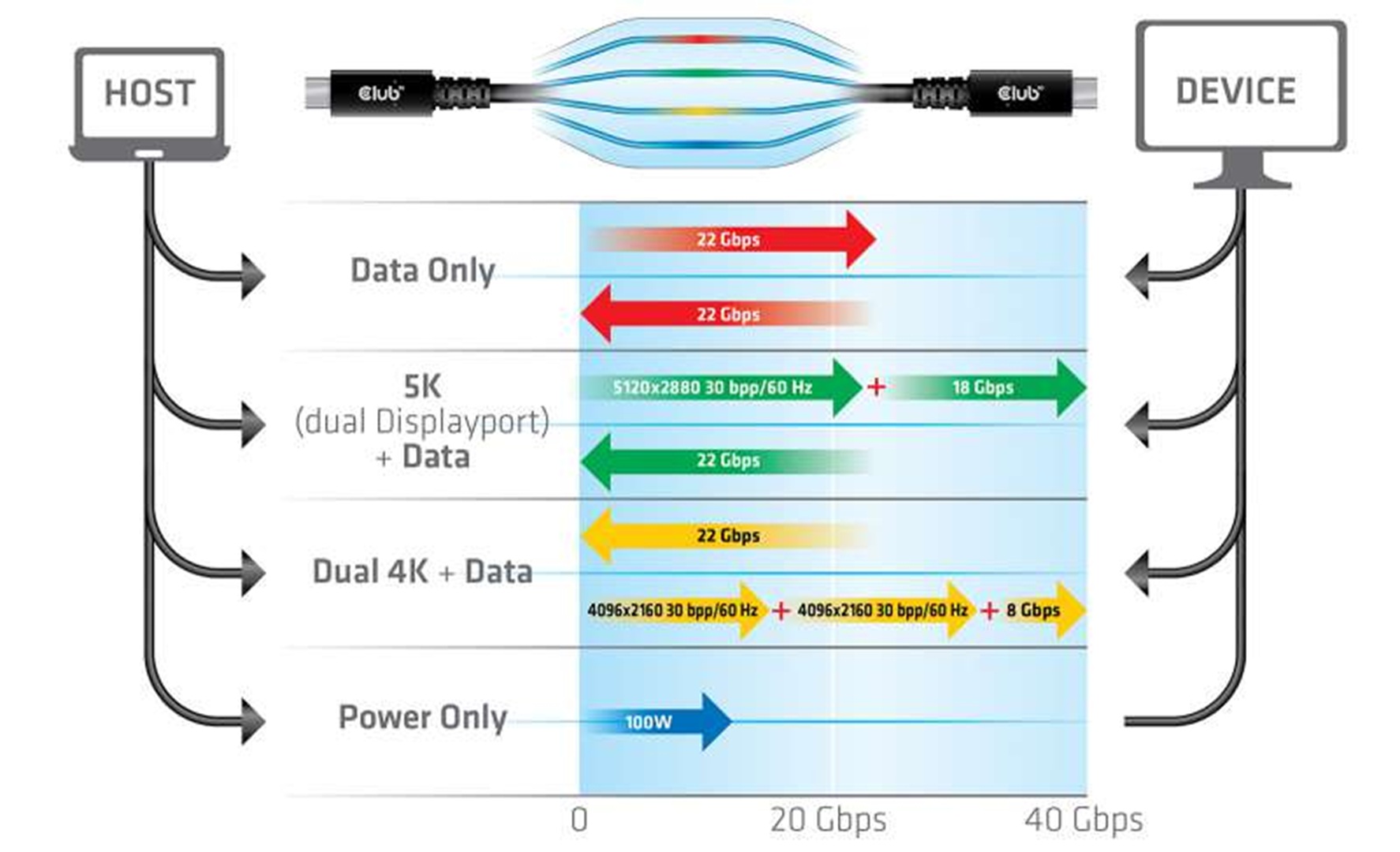

Thunderbolt™3 Mode. If a cable and device supporting Thunderbolt™ are plugged in, the Thunderbolt™ silicon activates its highest capability mode, and links two bidirectional links at either 10Gbps or 20Gbps or 40Gbps. Additionally, to fill this Thunderbolt™ link, the silicon extracts and routes up to four lanes of PCI Express Gen 3 ( 4 x 8 Gbps ) and up to two ( four lane ) full links of DisplayPort out over the Thunderbolt cable and connector to the device(s) attached downstream from the host system.

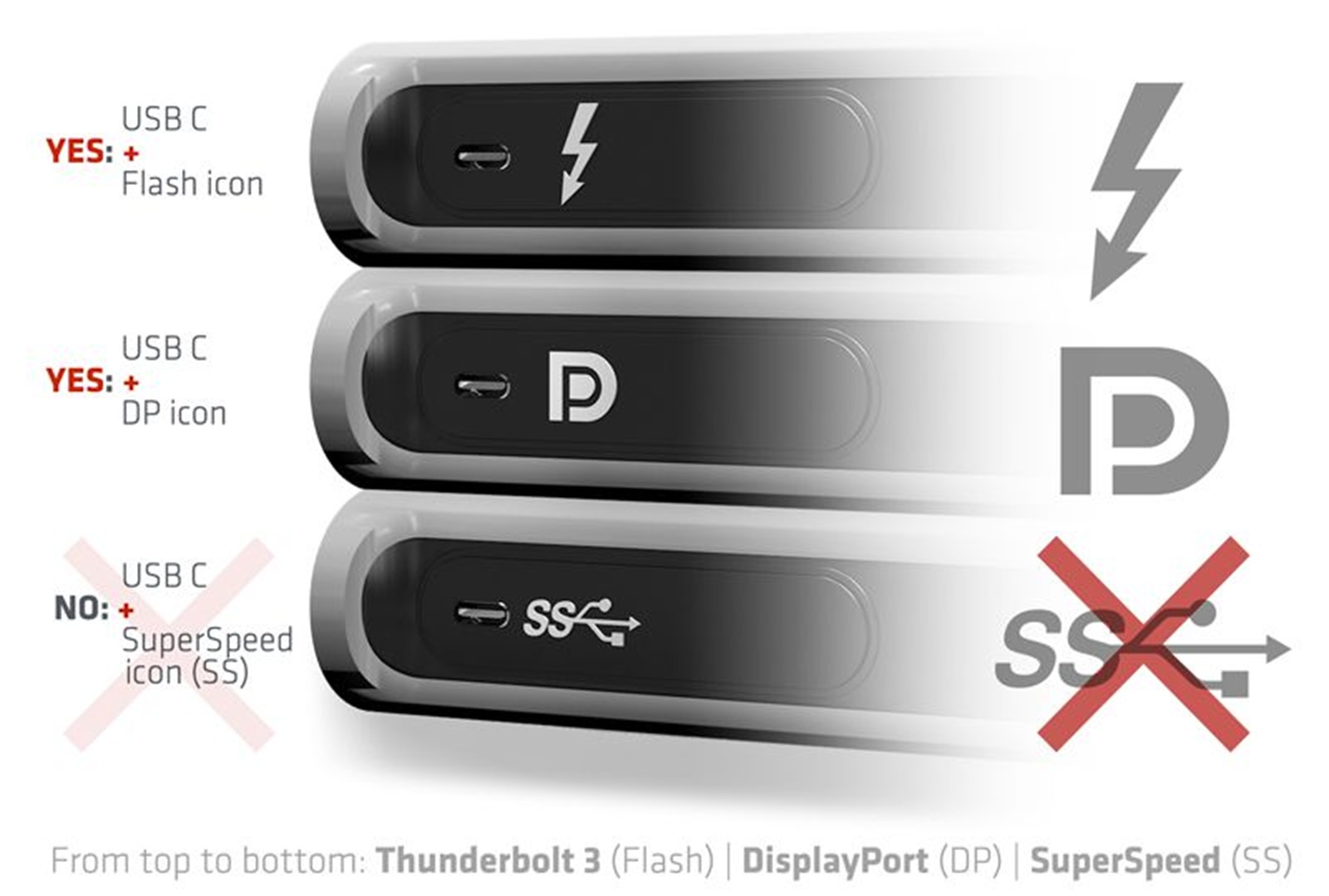

Symbols on USB-C Plugs

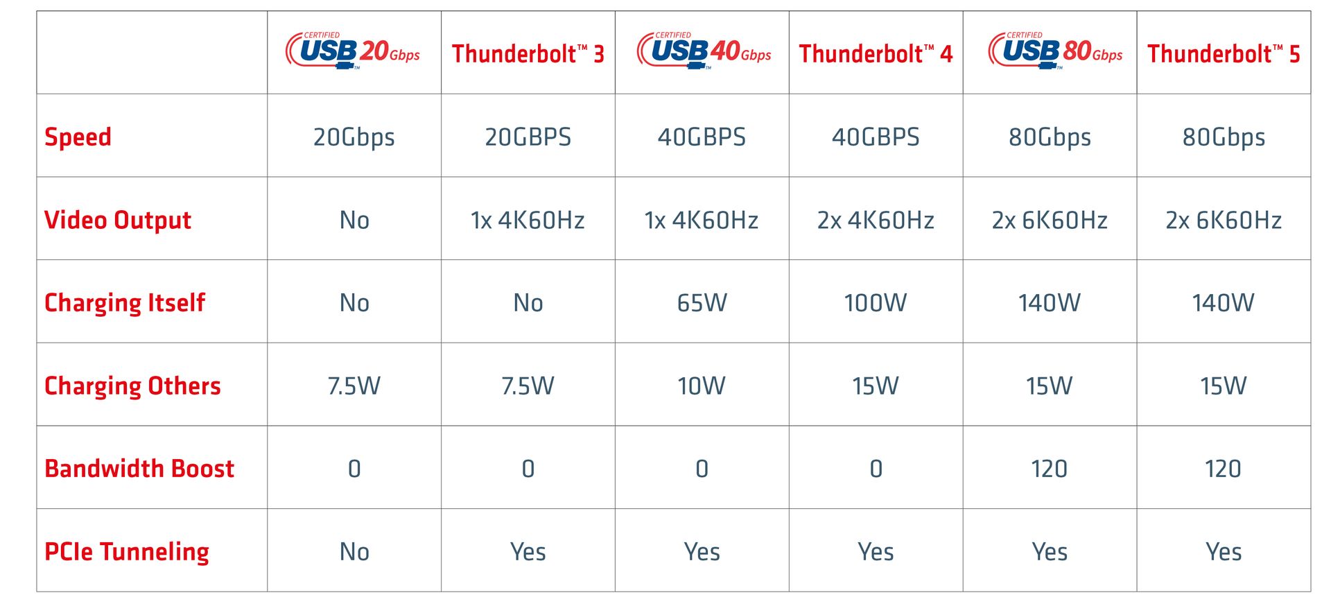

Introducing Thunderbolt™  4

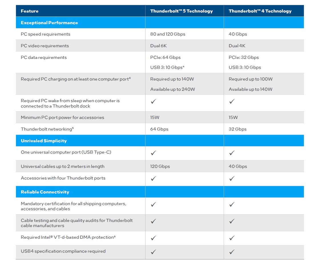

Intel revealed new details in July 2020 about Thunderbolt™ 4, the next generation of its universal cable connectivity solution, delivering increased minimum performance requirements, expanded capabilities and USB4 specification compliance.
For the first time, Thunderbolt™4 will offer docks with up to four Thunderbolt™ ports and universal cables up to 2 meters in length. Intel’s upcoming mobile PC processors, code-named “Tiger Lake,” will be the first to integrate Thunderbolt™4.
Thunderbolt™  provides consumers with a leading connectivity standard across a range of devices, helping to advance computing experiences and delivering on the promise of USB-C with simplicity, performance and reliability. The arrival of Thunderbolt 4 underscores how Intel is advancing the PC ecosystem toward truly universal connectivity solutions.
