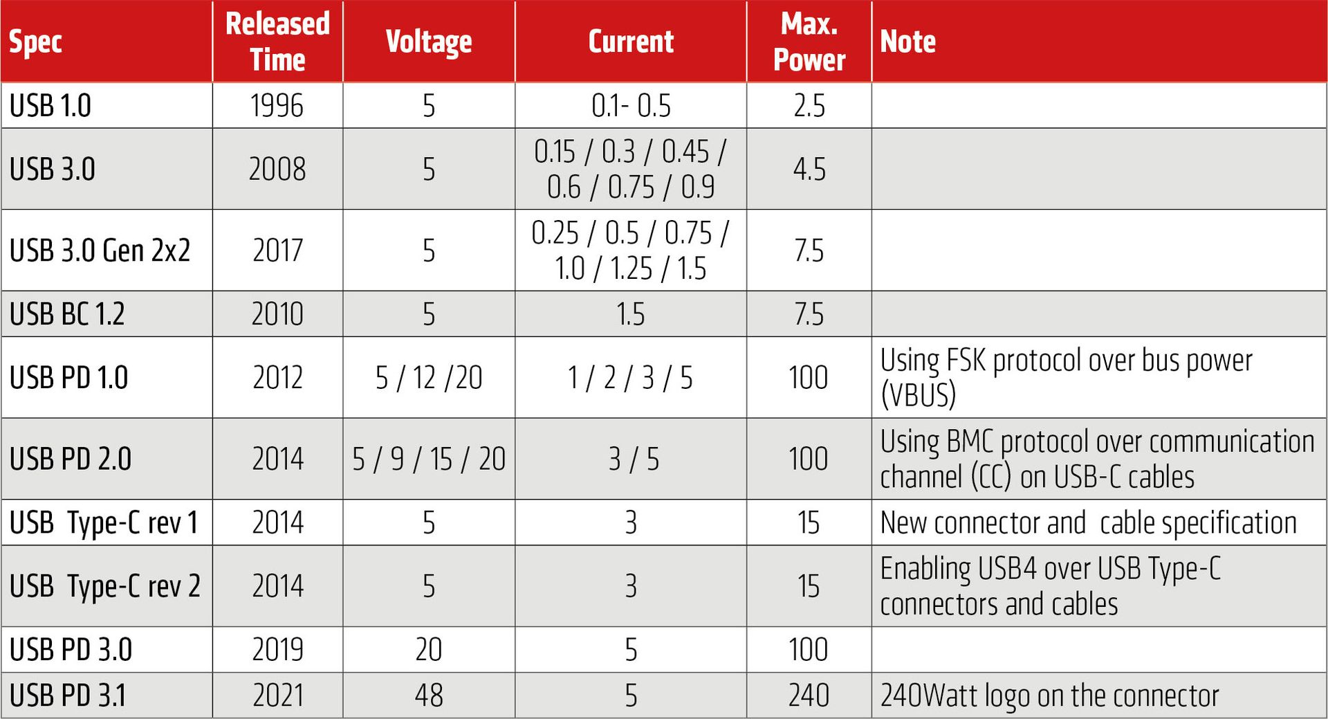

There’s a good chance that most of your electronic gadgets charge from USB, but it wasn’t initially designed to provide much power. USB Power Delivery (PD) changed this in a major way, making power-hungry devices on USB a possibility. Standard USB Power Is a Little WeakStandard USB power specifications don’t offer much in the way of power. There are various USB power standards that devices can call on. Which ones are available depends on what type of USB standard the controller, cable, and device all support. For example, USB 3.2 Gen x2 offers at most 7.5W while USB 3.0 offers 4.5W.
There are special battery charging standards over USB that can pump up to 25W of power into a device and standard USB-C can deliver up to 15W of power, assuming that the charger can provide 3A of current.
Why are USB power standards so limited? The answer is somewhat complicated, but the common denominator here is that all of these standards, even the latest USB-C standard, operate at a mere 5V. Since the total wattage that can be delivered is a product of voltage and current, the only way to give more watts at 5V is to increase current. However, as the Amps go up you’ll run into various issues such as needing thicker wiring and of course, the level of current can quickly become dangerous.
USB Battery Charging (BC) 2 offers the most watts at 5V and 5A, totaling 25W. Fast-charging smartphones, tablets, and modern laptops can easily meet and exceed that number. Quite a few proprietary USB fast-charging methods have been developed to address this, and USB PD exists as a way to accommodate these growing power needs in an industry-standard way.

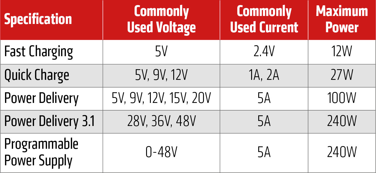

What’s the Difference Between PPS, PD, and QC?Programmable Power Supply PPS allows for stepwise changes in current and voltage. It decreases the conversion loss during charging, ensuring the charge is more efficient. When the charge is more efficient, less heat is produced, and when less heat is produced, a battery’s lifespan increases. So, PPS fast charging is better for your device’s battery.
PD charging
USB Power Delivery Adds The VoltsThe first version of USB Power Delivery running over Micro-USB offered 60W at 3A, which means that it’s also pushing 20V. That’s four times as much as the base-level USB standard. PD 1.0 on USB Type-A/B upped this to 5A, offering 100W of power.USB-C Power Delivery comes in two power levels. PD 2.0 and 3.0 over USB-C have the same 100W power rating as PD 1.0 over Type-A/B connectors. Power Delivery 3.1, however, offers a whopping 240W of power by pushing the voltage up.USB PD never exceeds 5A of current, but the voltage can be dynamically configured to meet the needs of a device up to the maximum power limit for the standard.

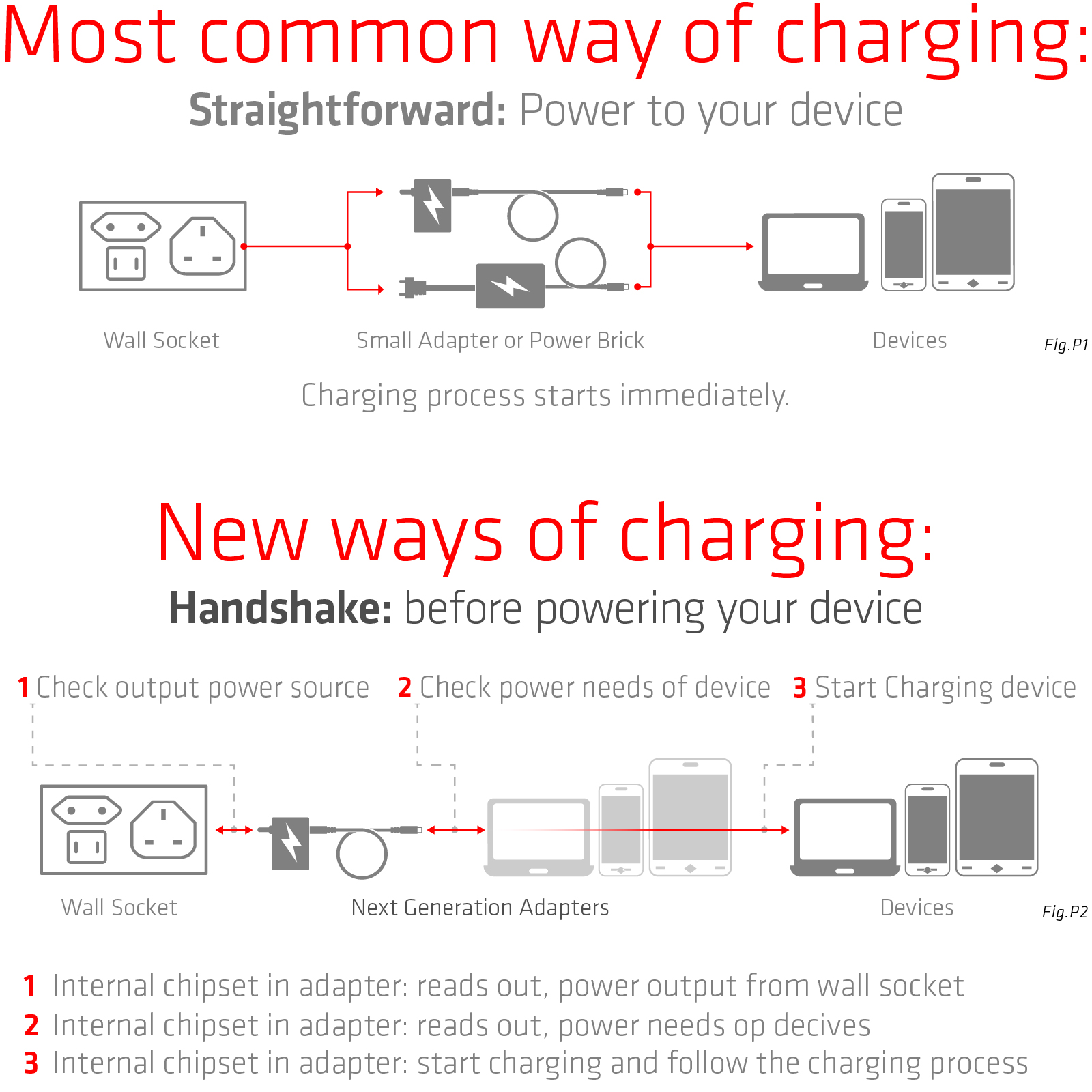

The Device Handshake
When a USB PD charger connects to a device, it performs a “handshake” asking the device how much power it needs. USB PD supports seven voltage levels at 5V, 9V, 15V, 20V, 28V, 36V, and 48V.
