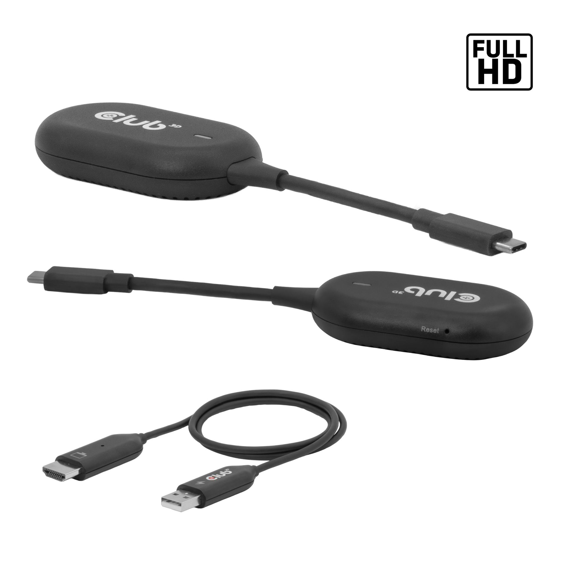

The CSV-2570 consist of
TX (Transmitter)
USB-C connection
Supports DP Alt Mode
Compatible with Windows, macOS, and ChromeOS devices
RX (Receiver)
HDMI output
Connects to TVs and monitors

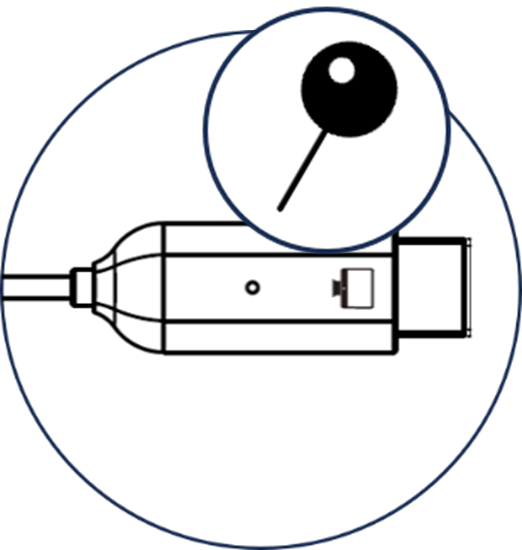

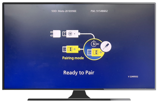

  4. Press and hold the reset button at the HDMI port to get the following prompt
RX is now ready for pairing

  2. Press and hold the Pair button for approximately 5 seconds
  3. Observe LED behavior:
    • LED stops
    • Then flashes quickly after ~1 second
  4. Release the button to start pairing

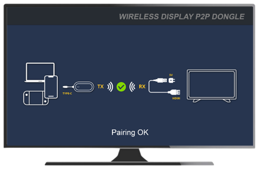

  5. Confirm:
    • “Pairing OK” is displayed
    • Screen output is normal
