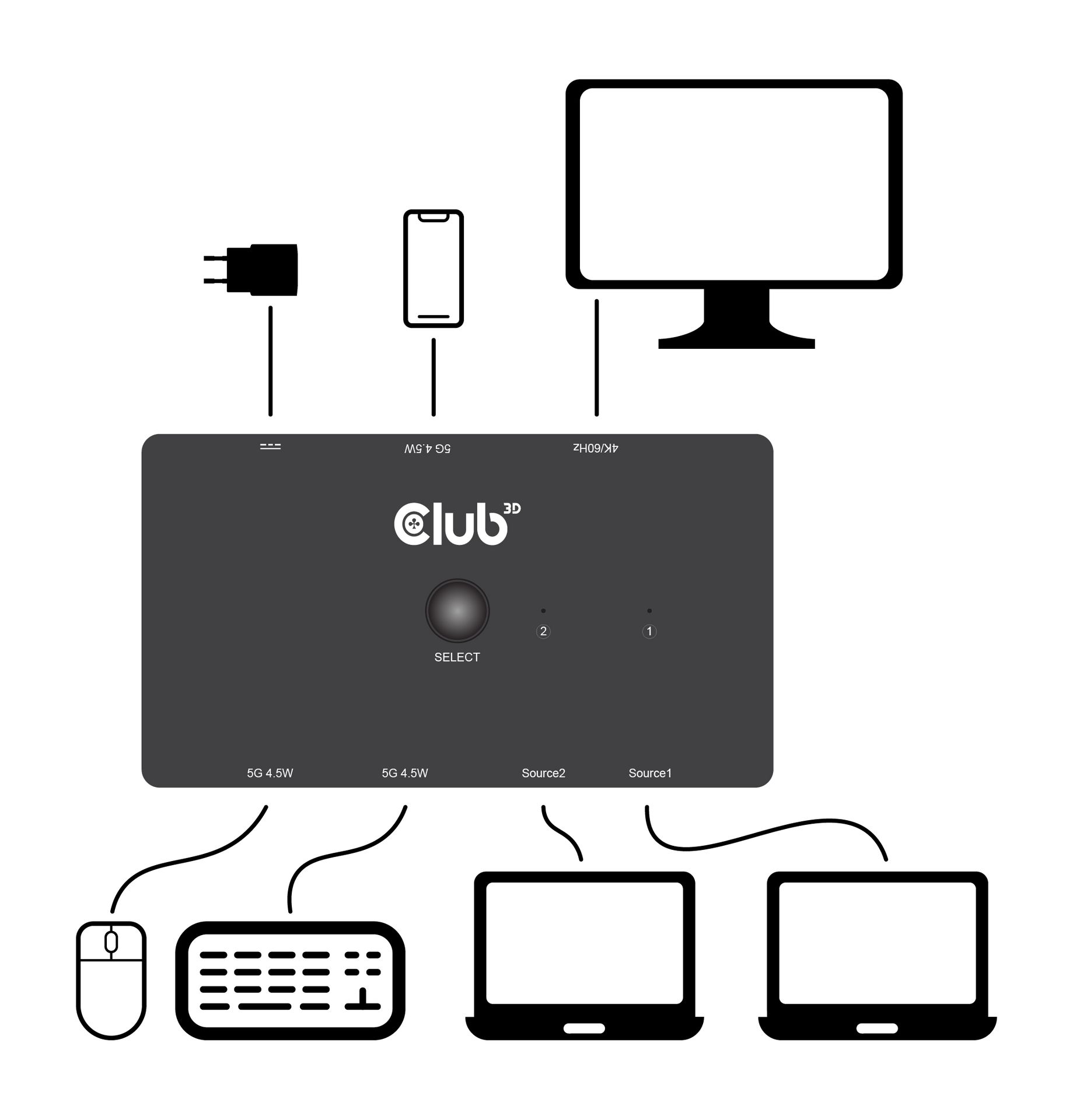

Connection Example: Two USB‑C® Hosts to One HDMI™ Display
This is the standard KVM use case.
  1. Connect Host System 1 to the USB‑C® port labeled Source 1 on the CSV‑2512.
  2. Connect Host System 2 to the USB‑C® port located near the USB‑A ports (Source 2).
  3. Connect the HDMI™ display to the HDMI™ output port on the CSV‑2512.
  4. Connect keyboard, mouse, and other USB peripherals to the USB‑A ports.
  5. If host charging is required, connect a USB‑C® Power Delivery adapter to the USB‑C® PD charging port.
