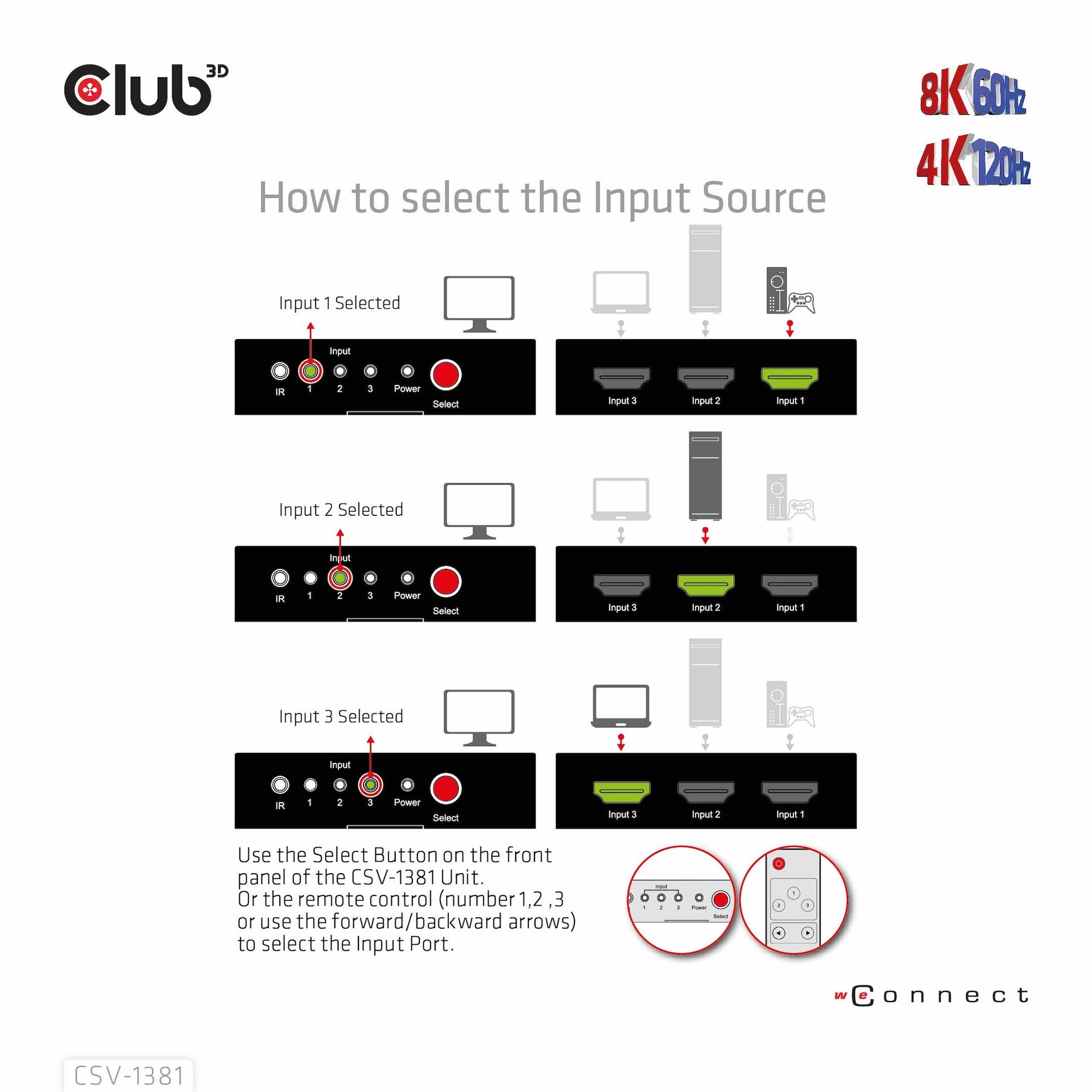

Switching Methods
The active HDMI™ input can be selected using:
  • The Select button on the front of the unit
  • The IR remote control
  • Forward/backward selection using the remote
The active input is indicated by the illuminated LED on the front panel.

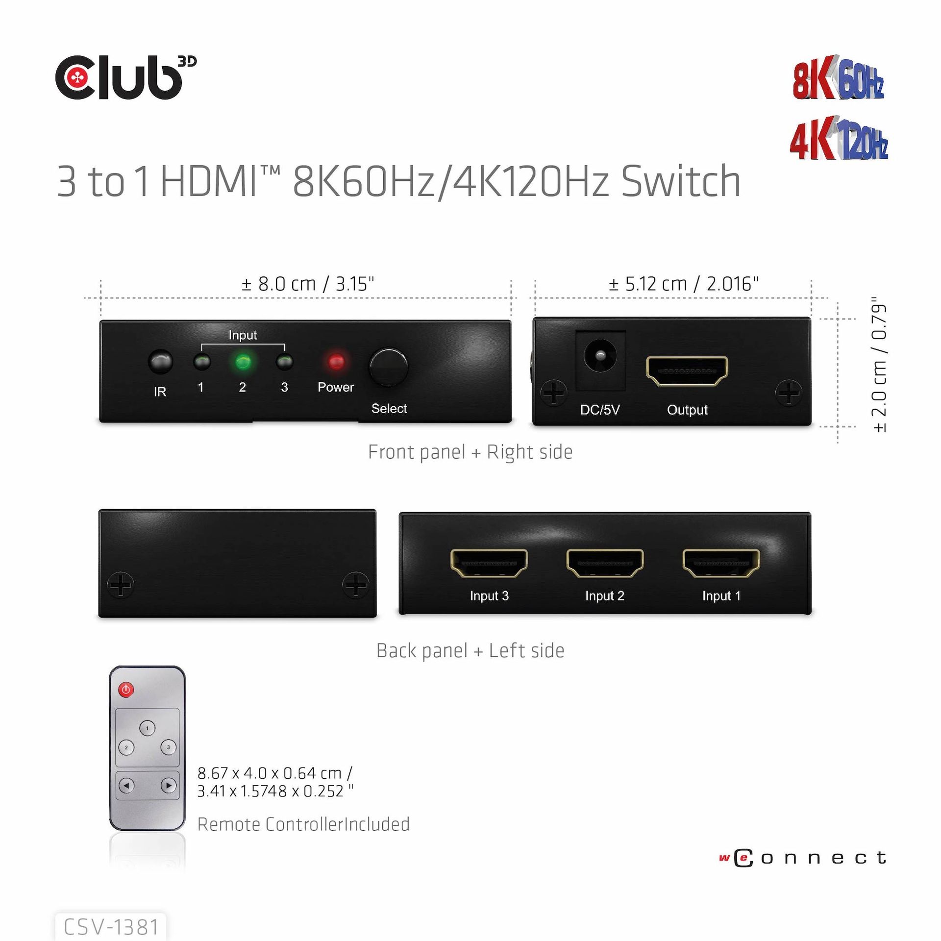

Connection Instructions
  1. Remove the protective insulation from the remote‑control battery.
  2. Connect the HDMI™ display to the connector marked Output.
  3. Connect up to three HDMI™ source devices to the HDMI™ input ports.
  4. Connect the supplied power adapter to the DC power input.
  5. Power on the display and source devices.
  6. Select the desired input using the front button or the remote control.
